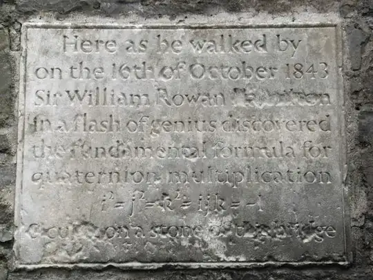

    Just for information, if memory serves me correctly the last line (which is pretty illegible here) reads "...and carved it on a stone of this bridge". –  Aug 28 '14 at 13:07
