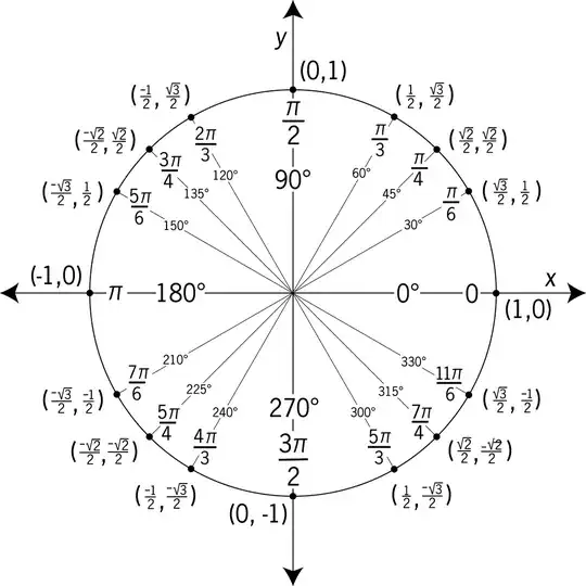

As I understand it... ahem... the (cosine, sine) vector was calculated for (30 degrees, PI/6), (45 degrees, PI/4) and (60 degrees, PI/3) angles etcetera, however, I would like know the original geometrical process for calculating the magnitudes for each vector in the trigonometric lookup table.
How did people calculate these values before calculators? Did people simple measure the adjacent and opposite lengths with accuracy?
Unit Circle
