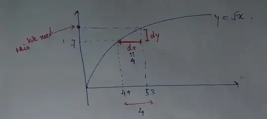

Just found an interesting way to find square root of a number using Derivatives. All the above answers are awesome, but this method just blew my mind.This method is a trade off between accuracy and time taken to get the result.
Lets take an example. Say $\sqrt{53}$.
Consider $y = \sqrt{x}$ graph
pic2
We have $$y = \sqrt{x}$$ $$dy = \frac{1}{2\sqrt{x}}dx$$
Now, at $x\approx49$ and $dx=4$ $$dy = \frac{1}{2\sqrt{49}}dx$$ $$dy = \frac{2}{7} \approx 0.28$$
Therefore $$\sqrt{53} = 7 + dy = 7.28$$
The results might get a little inaccurate after $\approx$100 because the perfect squares get more sparsely populated and thus making $dx$ comparatively nearer to $x$. Therefore always try to take out all the integers you can from inside the square root and then apply this method on whatever remains inside.
Obviously for this, you need to know the nearest (just less than) perfect square to the given number. But I guess, a little trial and error should get you that perfect square.
Jdeep
  • 303
