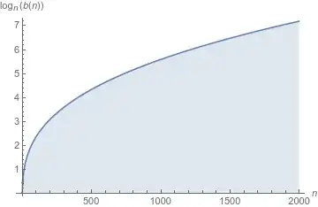

For large arguments, we need to prevent the mild attempts to prevent infinite loops.
Block[{
    $RecursionLimit = 5000,
    $IterationLimit = 5000
  DiscretePlot[{Log[n, b[n]]}, {n, 2, 2000}]
Prime partition function for arguments up to 2000
TableForm[Table[{100 k, b[100 k]}, {k, 1, 30}]]
$$ \begin{array}{rr} n & b(n) \\ \hline 100 & 40\,899 \\ 200 & 9\,845\,164 \\ 300 & 627\,307\,270 \\ 400 & 20\,075\,018\,700 \\ 500 & 414\,270\,104\,287 \\ 600 & 6\,267\,622\,640\,718 \\ 700 & 75\,023\,235\,861\,131 \\ 800 & 746\,579\,898\,675\,387 \\ 900 & 6\,392\,242\,051\,193\,026 \\ 1000 & 48\,278\,613\,741\,845\,757 \\ 1100 & 327\,744\,293\,190\,020\,336 \\ 1200 & 2\,029\,147\,863\,444\,364\,710 \\ 1300 & 11\,590\,550\,282\,322\,997\,472 \\ 1400 & 61\,654\,092\,345\,462\,767\,992 \\ 1500 & 307\,767\,211\,680\,878\,103\,266 \\ 1600 & 1\,450\,997\,588\,181\,557\,017\,431 \\ 1700 & 6\,495\,951\,378\,101\,560\,661\,960 \\ 1800 & 27\,743\,014\,519\,009\,825\,296\,856 \\ 1900 & 113\,481\,312\,640\,973\,435\,202\,574 \\ 2000 & 446\,121\,153\,521\,479\,463\,708\,832 \\ 2100 & 1\,690\,633\,708\,394\,918\,231\,947\,808 \\ 2200 & 6\,192\,537\,346\,397\,477\,180\,809\,944 \\ 2300 & 21\,975\,198\,457\,476\,870\,147\,875\,871 \\ 2400 & 75\,709\,986\,489\,697\,972\,886\,549\,803 \\ 2500 & 253\,714\,665\,648\,596\,332\,053\,234\,626 \\ 2600 & 828\,407\,291\,699\,814\,300\,659\,000\,601 \\ 2700 & 2\,639\,436\,199\,390\,992\,422\,102\,282\,380 \\ 2800 & 8\,217\,667\,977\,417\,902\,397\,061\,965\,136 \\ 2900 & 25\,032\,453\,880\,409\,897\,119\,453\,395\,767 \\ 3000 & 74\,692\,232\,370\,346\,735\,766\,630\,583\,120 \\ \end{array} $$
