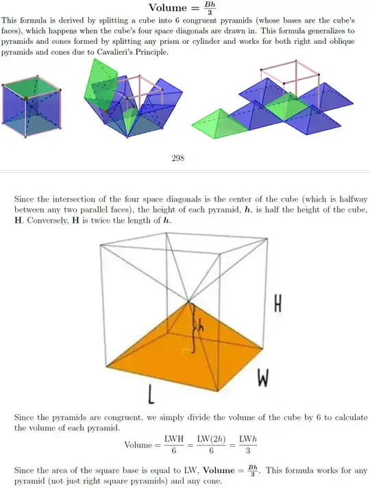

I actually find it easiest to take a cube and divide it into 6 pyramids: just connect all of the corners of a cube to the midpoint, and for each of the 6 faces of the cube, you get a pyramid having that face as its base. If the cube has a side length s, then each pyramid has an s by s base and height s/2, and its volume is 1/6 the volume of the cube, which is 1/3 base times height.

"1/6 the volume of the cube, which is 1/3 base times height" — "height" being "half the height of a cube" due to the pyramids in the example having their apex at the cube’s center. – endvvell May 15 '25 at 19:13

Carrying off on Gabe's answer I would like to add a little bit of detail:
Quick summary:
You have 6 pyramids in a cube.
Cube details:
The base of the cube = $\textrm{s} \cdot \textrm{s} = \textrm{s}^2$
The height of the cube = s
The volume of the cube = $\textrm{s} \cdot \textrm{s} \cdot \textrm{s} = \textrm{s}^3$
Square-based pyramid details:
The base of each square pyramid is the same as the base of the cube = $\textrm{s} \cdot \textrm{s} = \textrm{s}^2$
The height of each pyramid is half the height of the cube = $\frac{\textrm{s}}{2}$
The volume of the square-based pyramid is as mentioned 1/6 the cube = $\frac{\textrm{s}^{3}}{6}$
Solving:
Now if we cut the cube in half at the midpoint from the top of the cube we can isolate one of the pyramids inside the half cube.
Volume of half cube = length $\cdot$ width $\cdot$ height = $\textrm{s} \cdot \textrm{s} \cdot \frac{\textrm{s}}{2} = \frac{\textrm{s}^{3}}{2}$
Now to find the volume of the pyramid:
$$\frac{\textrm{s}^{3}}{2} - \frac{\textrm{s}^{3}}{6} = \frac{\textrm{s}^{3}}{3}$$

Put together 6 pyramids to make a cube. You will see that volume of whole cube can be considered as sum of 2 equal smaller volumes (area by half-height of cube). Its also the height of pyramid multiplieds by area. The small volume is also the sum of 3 pyramids, because 3 is half of 6. So single pyramid is 1/3rd of this multiplication.
- 9,369
