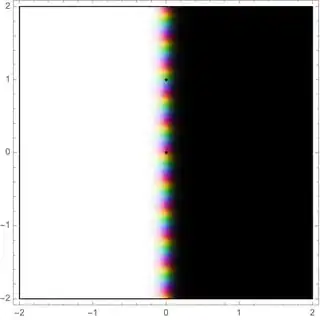

In the context of the Riemann sphere, \begin{align} 0^s = \begin{cases} 0 & \Re(s) > 0 \\ \infty & \Re(s) < 0 \\ 1 & s = 0 \end{cases} \end{align}
The case $\Re(s) = 0 \land s \neq 0$ is trickier. The best I can say is
\begin{align} |0^s| = 1 \end{align} for such $s$, since
\begin{align} \lim_{\varepsilon \to 0} |\varepsilon^s| = 1 \end{align}
But the limit of the argument no longer exists. Perhaps a generalized limit might give us an answer there. See the following plot for a visualization:
With[{\[Epsilon] = .0000001},
 ComplexPlot[\[Epsilon]^s, {s, -2 - 2 I, 2 + 2 I},
  ColorFunction -> "GlobalAbs", Epilog -> {
    Point[{0, 0}],
    Point[{0, 1}]
$s = 0$ (the bottom dot) retains the same value no matter the value of $\varepsilon$, but this is not true for $s = i$ (the top dot).
