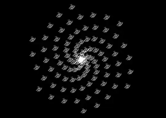

Here are my two test case spirals below, with images. I'd appreciate a nudge in the right direction on how to get these image particles evenly spaced throughout each spiral form. Kind thanks!
An Archemedian spiral, with image:
// ARCHEMEDIAN SPIRAL
var r = 1;
var theta = 1;
for (var p = 0; p < particleCount; p++) {
    var pX = r * Math.cos(theta);
    var pY = r * Math.sin(theta);
    theta += 1;
    r += 10;
    // make an image particle at pX, pY
archemedian spiral

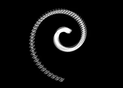

A logarithmic spiral, with image:
var r = 1;
var theta = 1;
var a = 100; // a constant
var b = 0.2; // another constant
    var pX = a * Math.cos(theta) * Math.exp(b * theta);
    var pY = a * Math.sin(theta) * Math.exp(b * theta);
    theta += 0.1;
logarithmic spiral

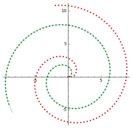

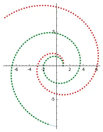

The first, approximate approach is drawn in red in the following figure, the second exact one in green. The continuous line behind the green points is a simple parametric plot of the exact solution.
Figure of logarithmic spirals

Exact curve but approximate distances
Or you could consider the change in $\theta$ induced by such a step in tangent direction. If you look at the derivative, then you notice that the radial component of that distance is $r$ while the tangential (to the circle) component is $r\theta$. So you have something like
$$s = x\sqrt{1+\theta^2}\qquad r\left(\theta_2-\theta_1\right) = x \\ \theta_2=\theta_1+\frac s{r\sqrt{1+\theta_1^2}}$$
def archspiral2(s):
    theta = s/2
    for c in range(100):
        yield (r*theta*cos(theta), r*theta*sin(theta))
        theta += s/(r*sqrt(1 + theta^2))
Figure of archimedean spirals
