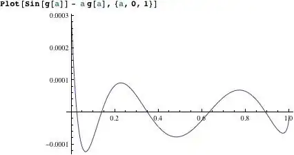

$$\tilde f^2(a):={p(a)\over q(a)},\qquad p(a):=c_0+c_1 a+ c_2 a^2,\quad q(a):=1+d_1a +d_2 a^2\ $$ Using nonlinear regression, I adjusted the five involved parameters in order to minimize $$SSQ=\sum_{i=1}^n \Big(\sin(\tilde f(a_i))-a_i \tilde f(a_i)\Big)^2$$ The values of the $a_i$ were generated using $1000$ equally spaced values of the $x_i$ between $0$ and $\pi$. I have not been able to compute formally $$\int_0^1 \Big(\sin(\tilde f(a_i))-a_i \tilde f(a_i)\Big)^2 da$$
Starting with the coefficients given in Christian Blatter's answer, the initial $SSQ=5.968\times 10^{-5}$ which is already very good. I arrived to $SSQ= 3.800\times 10^{-6}$. The corresponding parameters are $$c_0=9.86774920$$ $$c_1=4.91765690$$ $$c_2=-14.77935381$$ $$d_1=2.48744104$$ $$d_2=0.63396306$$ For these values, the largest error is $0.000295$ and the average error is $0.000052$ which is incredibly good. As a result, a single Newton iteration is basically required for the desired accuracy. In the following plot the function $\tilde f$ is denoted $g$:

Continuing working the problem, I set $$\tilde f^2(a):={p(a)\over q(a)},\qquad p(a):=\sum_{i=0}^n c_i a^i,\quad q(a):=1+\sum_{i=1}^n d_i a^i\ $$ and played with $n$. The first result is that moving to cubic polynomials changes a lot the result : $SSQ=4.9609379\times 10^{-10}$, maximum error $= 0.000004$, average error $< 0.000001$. This means that one single Newton iteration is required for a high accuracy. Mowing to fourth oder gives the solution without any Newton iteration.

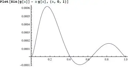

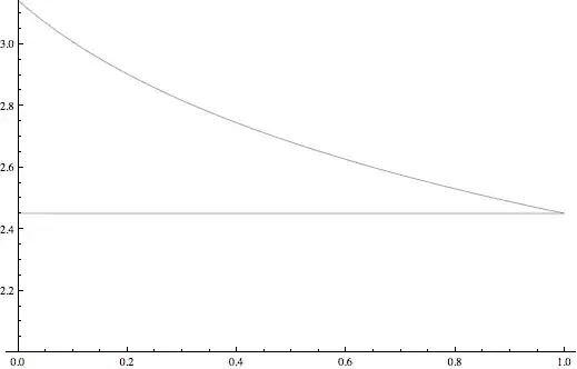

We have to solve the equation ${\rm sinc}(x)=a$ for $x\in[0,\pi]$ in terms of the parameter $a\in[0,1]$. As Kirill has remarked, for $a\to1\!-\ $ we obtain $x\doteq\sqrt{6(1-a)}$. Therefore, if we want a single simple expression giving accurate values over the whole $a$-interval $[0,1]$ we have to take a square root at the end.
For this reason we put $x:=\sqrt{u}$ and solve the equation $$\bigl(s(u):=\bigr)\quad {\rm sinc}\bigl(\sqrt{u}\bigr)=a\tag{1}$$ for $u$ in terms of $a$. Let $$a\mapsto u:=f(a)\qquad(0\leq a\leq1)$$ be the solution of $(1)$, i.e. the inverse function of $s$. From known values of $s$ and $s'$ we can, e.g., deduce the values $$f(0)=\pi^2,\quad f\left({2\over\pi}\right)={\pi^2\over4},\quad f\left({\sqrt{27}\over 4\pi}\right)={4\pi^2\over9},\quad f(1)=0\ ,\tag{2}$$ and $$f'(0)=-2\pi^2\tag{3}$$ (one could take more such values into account and determine more coefficients $c_k$, $d_k$ in the following).
We now make the "Ansatz" $$\tilde f(a):={p(a)\over q(a)},\qquad p(a):=\pi^2+c_1 a+ c_2 a^2,\quad q(a):=1+d_1a +d_2 a^2\ ,$$ and determine the coefficients $c_1$, $c_2$, $d_1$, $d_2$ such that $(2)$ and $(3)$ are satisfied. This leads to the approximation $$x=g(a):=\sqrt{\tilde f(a)}=\sqrt{{\pi^2+5.95839 a - 15.828 a^2\over 1 + 2.60371 a + 0.690687 a^2}}\ .$$ The following figure shows a plot of $a\mapsto \sin\bigl(g(a)\bigr)-a\> g(a)$:

  • I worked based on your ideas and I made a quite good approximation. I added that to my question and let it for your review (if you wish). I would have liked to add a plot similar to your; the problem is that I am blind and producing graphics is very very hard to me. May be, if you wish, could you add one ? Thanks again. – Claude Leibovici Sep 29 '14 at 04:59
  • My wife just tells me that the plot is very nice and illustrative. Thanks again. Cheers :) – Claude Leibovici Sep 29 '14 at 10:22

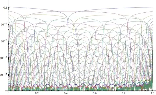

Now the red function $y(a)/\sqrt{1-a}$ is smooth, non-singular, has no roots, so we can approximate it with a Chebyshev series $\sum_{k\geq0}c_k T_k(x)-\frac12 c_0$, with these coefficients:
[5.468893253088218, -0.3315308418632746, 0.05711908619285262, -0.0133386391330606, 0.003604590132654065, -0.001061080932244192, 0.0003303619584939474, -0.0001070040549514469, 3.56907424708586e-5, -1.217702854008323e-5, 4.22996639149332e-6, -1.491025149248465e-6, 5.319859653014493e-7, -1.917577069128536e-7, 6.972596591016018e-8, -2.554518680989035e-8, 9.420605435988877e-9, -3.494307402618534e-9, 1.302781037141137e-9, -4.879450499229215e-10, 1.835088955571608e-10, -6.927187870873964e-11, 2.62374324329517e-11, -9.968294055829801e-12, 3.797891128370018e-12, -1.450731732722623e-12, 5.554781896411238e-13, -2.131593799567149e-13, 8.196531167958859e-14, -3.15778010597506e-14, 1.218720260971691e-14, -4.711359031839824e-15, 1.824159314975387e-15, -7.073133344264407e-16, 2.746327946190114e-16, -1.067647609986269e-16, 4.153961510615797e-17, -1.613912600904692e-17, 6.171147771603768e-18, -2.090308692683401e-18]
Depending on how much accuracy you need, it might be enough to sum the first 34 terms using the Clenshaw recurrence (this takes 33 multiplications, and uses no expensive operations, like divisions). Here is the plot of relative error for successive Chebyshev approximations to $y(a)/\sqrt{1-a}$:

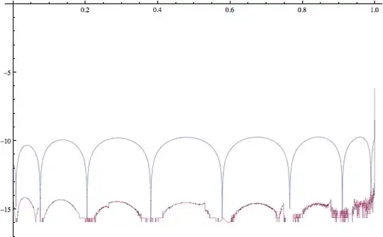

Depending on the relative cost of trigonometric operations on your machine (this should be established experimentally), it may be faster to take just enough Chebyshev terms that one Newton iteration suffices to get accuracy to machine precision. Here is 8 terms followed by one Newton iteration (blue) or one Halley iteration (red). The only expensive operation here would the simultaneous evaluation of sin and cos for the function and its derivative:
The cost of this is 7 multiplications for the Chebyshev series, and 4 multiplications, 2 divisions and one sin-cos for the Halley iteration, and one square root and a multiplication to get back $y(a)$.
