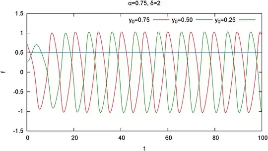

For example, for $\alpha=\frac{3}{4}$ and $\delta=2$, I numerically obtained the solution for different initial conditions $y_0$, and, as long as the initial condition is not the equilibrium point, it ends up in the same stable oscillation mode.
Example of delayed differential equation

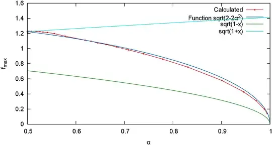

After finding the there is some bound present (see my incomplete answer below), I numerically investigated the behavior along the neutral curve:
$$ \delta=\frac{\arccos\left(\frac{3\alpha-2}{\alpha}\right)}{\sqrt{\alpha^2-(2-3\alpha)^2}},$$
and in the below figure I plotted the thus obtained $f_{max}$ as a function of $\alpha$. (Please be aware that the results are numerically obtained, and I did not carefully analyze the accuracy yet).
Maximum function value wrt alpha
Apparently, I found for the maximum function value the following relation
$$f_{max}=\sqrt{2(1-\alpha^2)},$$
which fits perfectly between $\sqrt{1-\alpha}$ and $\sqrt{1+\alpha}$ on the given domain for $\alpha$. This cannot be a coindicent, can it?

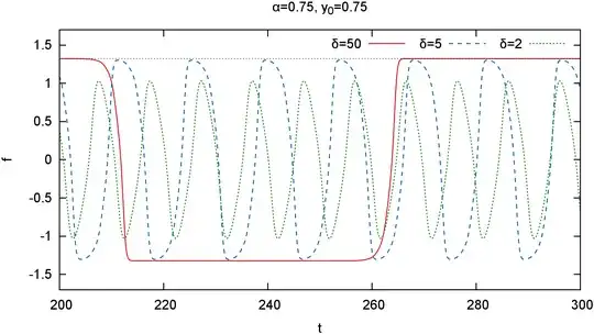

How close this absolute maximum is reached, depends, for given $\alpha$, mainly on the value of $\delta$. From below figure it can be seen that for larger $\delta$, the extreme value $f_{max}=\sqrt{1+\alpha}$ (dashed line) is reached more closely.
Example solutions

  • I still wonder if there are more informed guesses on the maximum value of the green line ($\delta=2$). – Bernhard Jul 18 '14 at 07:33
  • It seems correct and complete to me. Especially, you may look for all possible couples of $f_{\max}$ and $f(t_{\max}-\delta)$ by solving $0 = x -x^3 - \alpha y$ for $-x<y<x$. You then have two symmetric sets of possible solutions (plus the trivial one), and $x$ is maximal if it is $-y$, your case 2. – Joce Jul 23 '14 at 19:44
  • @Joce Well, it is correct for large $\delta$, but as you can see for the $\delta=2$ case, the maximum is clearly smaller than $\sqrt{1+\alpha}$ – Bernhard Jul 24 '14 at 07:01
  • Allright, I hadn't realized that what you're looking for is a the maximum for a given $(\alpha,\delta)$. You can calculte an upper bound $f_{\max}-f(t_{\max}-\delta)\leq \delta(1+\alpha)^{3/2}+o(\delta)$ using your d.e., combined with (1) this will provide a $\delta$-dependent bound on $f_{\max}$ that in some cases will be smaller than $\sqrt{1+\alpha}$ (the expression is lengthy, as you've to solve a cubic equation). If this is not sharp enough yet, you can derive your d.e. to get the next order (the $o(\delta)$), and so on. – Joce Jul 24 '14 at 07:32
  • @Joce This sounds really interesting! Do you have time to expand it to an answer? Is is not so obvious to me where the first expression in your comment comes from, so this might be an interesting lead for me! – Bernhard Jul 24 '14 at 07:45
  • I note now that being colour-blind can be a problem doing maths too: at first I thought the green line was what is actually the $\delta=50$ line, close to your bound...! – Joce Jul 24 '14 at 08:25
  • @Joce Please accept my apologies for the figure. In my anxiety to quickly make a figure I skipped over the dashedness I always use. I replaced the figure. – Bernhard Jul 24 '14 at 08:47
