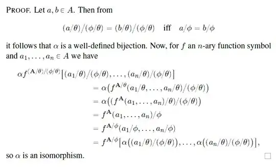

The following diagram is one classical way that the theorem is frequently "illustrated" (excerpted from Burris and Sankappanavar's A Course in Universal Algebra). Essentially the diagrams illustrate the set-theoretic view of the matter, in terms of equivalence classes or, equivalently, partitions. Before studying the algebraic versions of these theorems, for motivation, it helps to have a good grasp on their much simpler set-theoretic versions, i.e. "forget" the algebraic structure (operations), so reducing from algebras and their maps (homs), to simply sets and functions. Then a congruence reduces to an equivalence relation (no operations to preserve), i.e. a partition, which leads to the vivid depiction below, in terms of finer and coarser partitions. enter image description here enter image description here

  • It seems this does not require that $\theta$ and $\phi$ being normal. How can one show that this equivalence reduces to normality. I knew normality is an equivalence. However, is this one to one correspondence between normality with this equivalence(i.e. normality iff equivalence)? – user45765 Jul 06 '14 at 18:21
  • @user45765 Above $\theta$ and $\phi$ are congruences. As in the classical case for $,\Bbb Z,,$ in universal algebra one defines a congruence as an equivalence relation that is compatible with all of the operations of the algebra. For algebras like groups and rings whose congruences are determined by single congruence class, this reduces to the classical definitions using normal subgroups and ideals, e.g. see here. – Bill Dubuque Jul 06 '14 at 18:28
