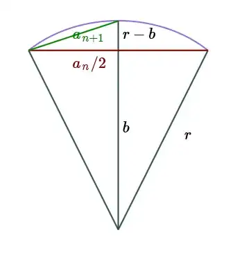

Remark 1: Here is the proof that the recursion formula (1) holds:
Let $a_n$ be the side length of the $2^n$-gon.
To obtain the $2^{n+1}$-gon: take the "outer end point" of the radii of the circle that bisect the faces of the $2^n$-gon to form the new vertices of the $2^{n+1}$-gon.
We then have, for $a_{n+1}$, the scenario shown in the following diagram (not to scale):
Now $$ b^2=r^2-{a_n^2\over4}; $$ whence $$\eqalign{ a_{n+1}^2={a_n^2\over4} + \Biggl((r-\sqrt{ r^2-{a_n^2\over4}}\ \Biggr)^2 &={a_n^2\over4}+ r^2-2r\sqrt{r^2-{a_n^2\over4}}+r^2 -{a_n^2\over4}\cr &= 2r^2-2r\sqrt{r^2-{a_n^2\over4}}\cr &= 2r^2-r^2\sqrt{4-{a_n^2\over r^2}}\cr &= r^2 \Biggl(2-\sqrt{4-{a_n^2\over r^2}}\ \Biggr).}$$ And, thus $$ a_{n+1}= r \sqrt{2-\sqrt{4-{a_n^2\over r^2}}}. $$
