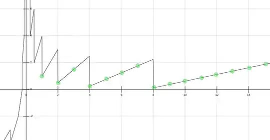

Positive dyadics rationals less than 1 are:
$$\large \frac{n+1/2}{2^{ \lfloor log_2 n \rfloor }} -1$$
Using this form:
(x+1/2)/(2^floor(log(abs(x))/log(2)))-1
I graph this:
odd numerators over increasing power of 2 denominators
*graph shows a range of 0..2, but the formula is actually ranged 0..1.
a progression of odd numerators over increasing power of two denominators at positive integer intervals.
from math import log2,floor
from fractions import Fraction
def dyadics(n=Fraction(1,1)):
    while 1:
        yield (2*n+1)/2**floor(log2(n)+1)-1
        n += 1
in_sequence = dyadics()
for n in range(2**4):
    print(next(in_sequence))
1/2, 1/4, 3/4, 1/8, 3/8, 5/8, 7/8, 1/16, 3/16, 5/16, 7/16, 9/16, 11/16, 13/16, 15/16, 1/32
