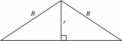

In this answer, it is shown that $$ d^2=R(R-2r) $$ where $d$ is the distance between the circumcenter and the incenter, $R$ is the circumradius and $r$ is the inradius. This is known as Euler's Circle Theorem.
If the triangle is equilateral, its circumcenter and incenter coincide; thus, $d=0$, and therefore, $R=2r$.
Suppose that $R=2r$, then $d=0$, and the incenter and the circumcenter coincide. Then each side of the triangle is $$ 2\sqrt{R^2-r^2} $$ since the distance from the incenter to each side is $r$ and the distance from the circumcenter to each vertex is $R$:
$\hspace{3.6cm}$enter image description here
Since each side of the triangle is the same, the triangle is equilateral.
So the answer is true.
