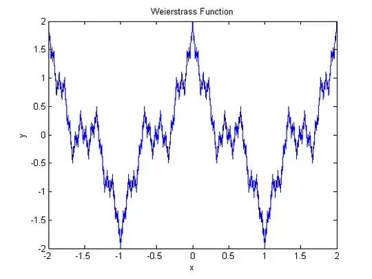

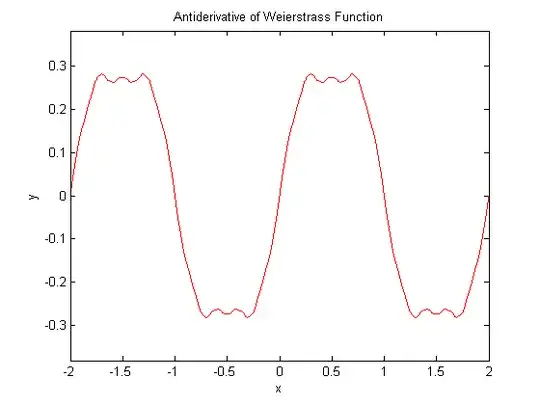

49
I plotted the Weierstrass function $f(x) = \displaystyle\sum_{n = 0}^{\infty}\dfrac{1}{2^n}\cos(3^n\pi x)$ and its antiderivative $F(x) = \displaystyle\sum_{n = 0}^{\infty}\dfrac{1}{6^n\pi}\sin(3^n\pi x)$. Here is what they look like:
Weierstrass Function
The antiderivative of the Weierstrass function is fairly smooth, i.e. not too many sharp changes in slope. This just means that the Weierstrass function doesn't rapidly change values (except in a few places).

    What did you use to plot these? –  Jun 11 '14 at 01:46
    MATLAB. It took me a bit of playing around to figure out what values of $a$ and $b$ were used to generate the picture on Wikipedia. – JimmyK4542 Jun 11 '14 at 01:52
    Neat. What specifically did you run to get your second picture? I might try and run a longer computation to get an even better picture. –  Jun 11 '14 at 01:53
    I computed the sum of the first 25 terms in the series for values of x ranging from -2 to 2 in increments of 10^-5. It ran in about 6 seconds (MATLAB is slower than other languages). With 25 terms, we get a maximum error of ~6.0x10^-8 for the function and ~1.3x10^-20 for the antiderivative. – JimmyK4542 Jun 11 '14 at 02:07
  • Is $F(x)$ differentiable? – Calmarius Jan 09 '16 at 16:30
    ^Since $f(x)$ is continuous, $F(x) = \int_0^xf(t),dt$ is differentiable and $F'(x) = f(x)$ everywhere. – JimmyK4542 Jan 09 '16 at 21:28
