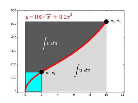

I've always found it helpful to think about it like this: (picture source)
The area of the gray areas combined is $u_2v_2 - u_1 v_1$, which is where the $uv$ term comes from.

  • I am new to the math SE. What software/tool did you use to make this (beautiful) plot+captions? – boardbite Jun 09 '14 at 22:52
    I saw something like this in my high school calc textbook, but I found this one through Google. If I were to make one like this, I'd probably use a vector graphics tool like Inkscape. – Henry Swanson Jun 09 '14 at 23:24
    @boardbite - the linked blog shows the entire python source of that plot. – Bach Jun 10 '14 at 09:08
    I don't really understand the picture...maybe you can explain what is going on. I see how it is a mnemonic for remembering the formula. – Eric Auld Nov 23 '15 at 18:11
    @Eric Auld From the limits $a,A$ (the lower black circle) and $b,B$ (the upper black circle) we have the integral of a function and its inverse in such a way that, as integration by "parts", we have the combined area of the two integrals that can be given by the difference between the larger square ($area=bB$) and the smaller square ($area=aA$). The area of the larger square minus the smaller square ($bB-aA$) is therefore equal to the sum of the integral of $u$ and the integral of its inverse $v$. In other words, $bB-aA=\int_a^budv+\int_A^Bvdu$ or whatever equivalencies. –  Apr 10 '18 at 12:12
