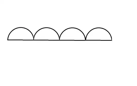

False. You need both $\alpha_n \rightarrow \alpha$ and $\alpha'_n \rightarrow \alpha'$, because the length is defined through $\alpha'$.
Otherwise, the attached image shows you how you could prove that any segment is equal to $\pi$ times its length.
The problem on the figure is that, when you take a close look at the path when divided in a large number of half-circle, you see that the derivative (i.e. the direction) of the sequence is every where distinct of the straight line.
So all what you can say about position ($\alpha_n \rightarrow \alpha$) passes to the limit, but what ever you can say which involve the derivative (length, angle, volume,...) do not.
