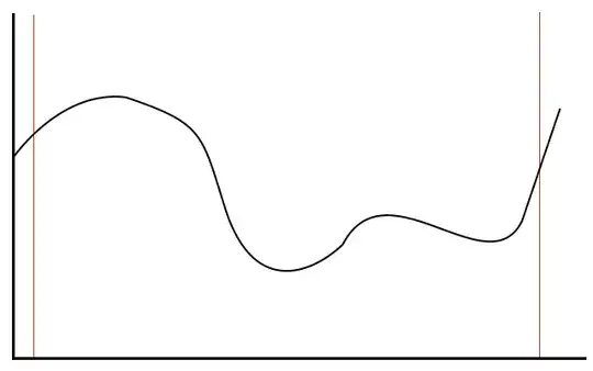

The basic problem we are trying to solve is to try to find the area under some curve over some interval. In this case this is the region bounded by the wiggly line, the $x$-axis, and the two vertical brown lines:
In fact, it's not actually clear what we mean by the "area under the curve"; we are trying to define that. But we do understand areas of rectangles, which are very simple. So we will try to divide up the region of interest into rectangles, and to approximate the area of the region as a sum of rectangles.

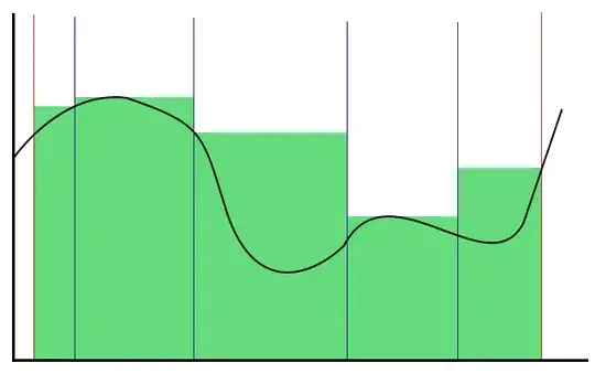

But how tall should we make the rectangles? One thing we could try is to make the rectangle for each interval as tall as the highest point of the curve in that interval:
If we add up these rectangles, we will get an estimate for the total area that is too large.

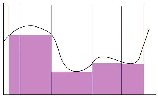

Another thing we could do is to make the rectangle for each interval only as tall as the lowest point of the curve in that interval:
If we add up these rectangles, we will get an estimate for the total area that is too small.
The actual total area will be in between these two estimates.
The area of the purple region is an example of a lower sum for the area of the region we want. The area of the green region is an example of an upper sum.
The actual area is more than the lower sum, and less than the upper sum. By comparing the lower and upper sums, we can get an approximate idea of the area we really want: it is more than some lower sum, but less than some other upper sum.

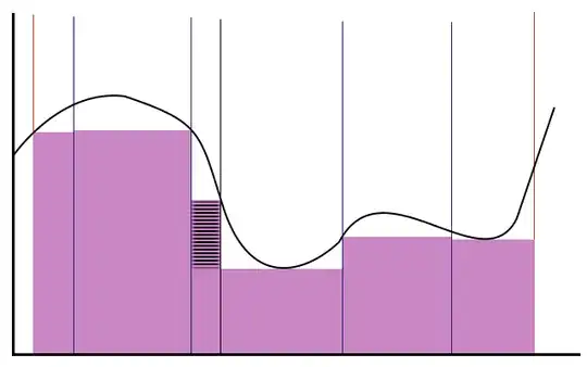

Now if we use more strips, we can show that the lower sum cannot decrease, and it may increase. For example, here I've divided one of the intervals into two. And one of the rectangles has gotten larger as a result, because the lowest point in that strip is higher than it was before I divided it.
Dividing the strips more finely increases the lower sum (or at least, doesn't decrease it) but decreases the upper sum. (You should draw the picture yourself for the upper sum to see what happens.)
