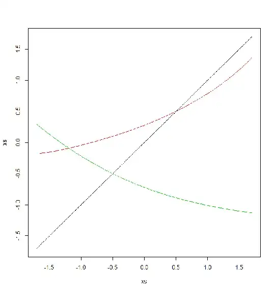

Taking some inspiration from Carlo Morpurgo's answer here, but I couldn't replicate his method exactly. My results are more general and allow for construction of solutions. As a summary of results: For $c\in(-1,1)$ there exists a unique function $f(x)$ such that $f'(x) = f(f(x))$ and $f(c)=c$. This function is analytic on an interval around $c$. For $c\ge 1$, there is no analytic solution. If $c\in(0,1)$, then the interval of analyticity $(c-R,c+R)$ satisfies $c+R>1$ and $f$ has no fixed point in $(c,c+R)$ and $\lim\limits_{x\rightarrow (c+R)^-} f(x) = c+R$.
Theorem 1: For any $c\in(-1,1)$ there exists a unique real solution to $f'(x) = f(f(x))$ in a neighborhood of $c$ such that $f(c) = c$.

The recurrence from Theorem 2 gives us an effective way to compute the Taylor series of $f$. Furthermore, the same recurrence applies to the derivatives at $c+R$; if we define $f^{(n)}(c+R) = \lim\limits_{x\rightarrow (c+R)^-} f^{(n)}(x)$, we'll have $$ f^{(n+1)}(c+R) = \sum_{k=1}^n f^{(k)}(c+R) B_{n,k}(f'(c+R),\dots,f^{(n-k+1)}(c+R)) $$ which gives a formal power series of $f$ around $c+R$, but by theorem 4, this series has radius of convergence $0$. As an example of some solutions: By my calculations, for $c = \frac12$, we would get \begin{eqnarray} f(1/2) &=& 0.5\\ f'(1/2) &=& 0.5\\ f''(1/2) &=& 0.25\\ f^{(3)}(1/2) &=& 0.1875\\ f^{(4)}(1/2) &=& 0.2109375\\ f^{(5)}(1/2) &=& 0.32958984...\\ f^{(6)}(1/2) &=& 0.66581726...\\ f^{(7)}(1/2) &=& 1.65652156...\\ f^{(8)}(1/2) &=& 4.90900657...\\ &\vdots& \end{eqnarray} and for $c= -\frac12$, we get \begin{eqnarray} f(1/2) &=& -0.5\\ f'(1/2) &=& -0.5\\ f''(1/2) &=& 0.25\\ f^{(3)}(1/2) &=& -0.0625\\ f^{(4)}(1/2) &=& -0.0546875\\ f^{(5)}(1/2) &=& 0.07861328...\\ f^{(6)}(1/2) &=& 0.00950626...\\ f^{(7)}(1/2) &=& -0.16376846...\\ f^{(8)}(1/2) &=& 0.17180684...\\ &\vdots& \end{eqnarray}
Here's a graph of $f_{1/2}(x)$ in red and $f_{-1/2}(x)$ in green, the line $y=x$ in black: Plot of f_{1/2} and f_{-1/2}
