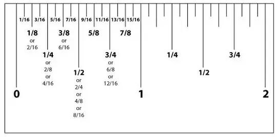

The numbers we construct kind of resemble the notches of a ruler
It is known these games generalize Dedekind cut construction of the real numbers from the Rationals. However $\mathbb{Q}$ hasn't been constructed yet... not even $\mathbb{Z}[\tfrac{1}{2}]$. How do we prove these simplicity rules?
