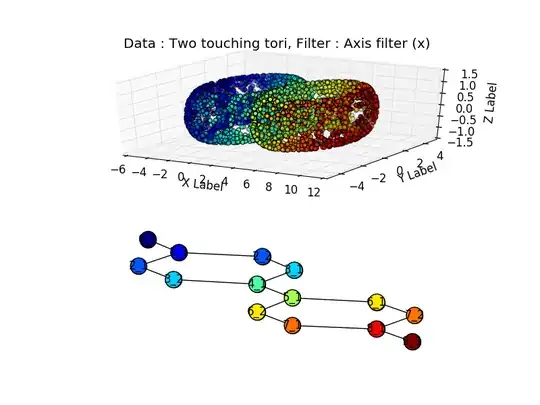

All the other answers are great! Focusing more on the implementation of ideas in topological data analysis, I wrote a tutorial on topological data analysis and keep a list of resources on topogical data analysis
The idea is to reproduce the pipeline presented in P. Y. Lum et al., “Extracting insights from the shape of complex data using topology,” Scientific Reports, vol. 3, no. 1, Dec. 2013. using Python.
This pipeline allows to turn a dataset into a graph, preserving connected components, as presented below.
touching tori
