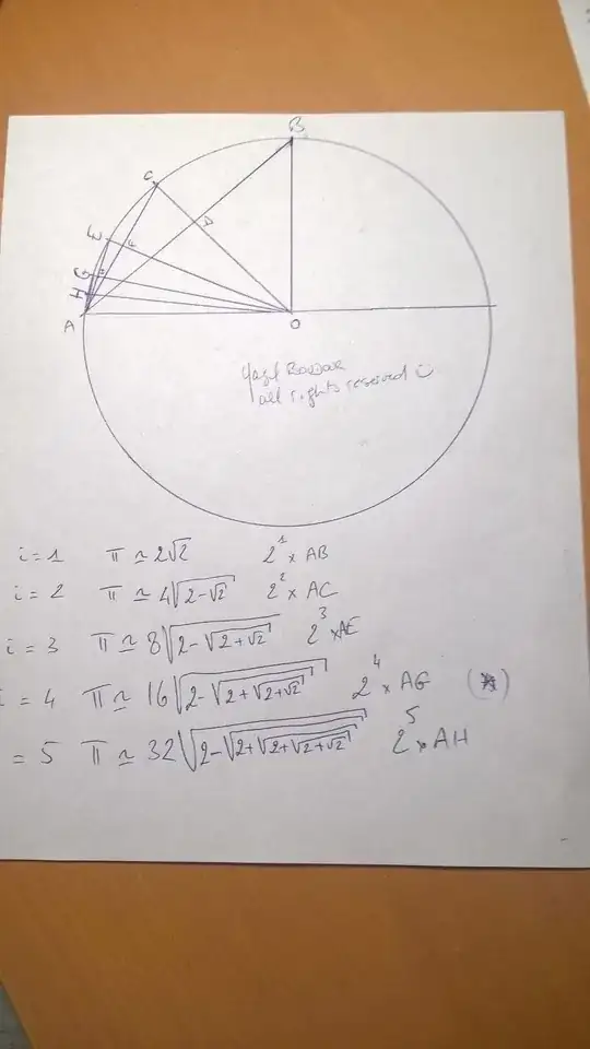

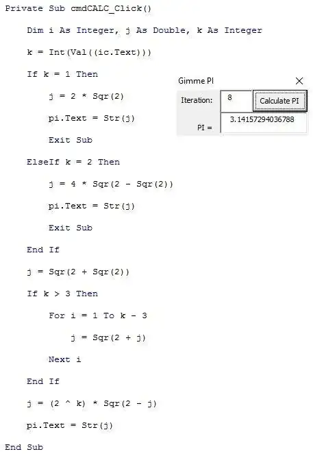

I had fun doing that back in the days; lots of paper and the smallest mistake would end in chaos. I felt I had discovered something in the end :) (Note: bug in the code snippet: k=3 is skipped; the line "if k>3 then" should be "if k>2 then".)
I was $17$ years old when I took on that task, alone at home with a lot of scratch paper. I remember the wow effect when the pattern emerged. It was about expressing PI in function of the square root of $2$. Focus recommended! In the last $35$ years, I mentioned it $3$ or $4$ times and it never raised much interest, probably because expressing an irrational number in function of another no more rational one does not make sense :). In iteration $3$, the function starts to look like the precedent one; then it's obvious between $3$ and $5$ and it goes on, making it easy to program. It will get closer to PI before breaking due to the variable's limitations. Here a code snippet (too) quickly put together for demo purposes.
Original post: https://www.facebook.com/yazel.boudour/posts/353578401680948
