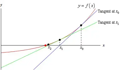

One method for approximating roots is Newton's Method, which uses a tangent line approximation to approach the actual value of a root.
Since it is given that $f(x) \approx f(x_0) + (x - x_0)f'(x_0)$, consider the function $f(x) = x^2 - 2$. Clearly, this quadratic has root $\sqrt{2}$. The goal is to get closer and closer to the y-intercept of this function (which is $\sqrt{2}$). We do this by taking the tangent line approximation of a value on the curve $x^2 - 2$ (say, $1.5$) and finding where that line intercepts the y-axis. Then, we plug the intercept in and get a new (more accurate) intercept.
(source: lamar.edu)
Check Paul's Online Notes for more info, or Wikipedia.
