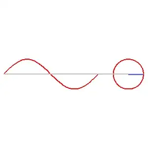

Graphically you can see that at $\theta = 0$ the derivative of the $\sin$ (the $y$-value) is changing the most as opposed to anywhere else (other than the other side of the circle at $\theta = \pi$):
Graph of unit circle with derivative
Here's another picture which shows that the shape of the sinusoid is due to the definition of sine in the first quadrant (forgive the approximate nature of this sketch--but it is basically correct):
