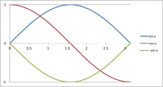

I am with Henning Makholm on this and produce a sketch
The slope of the blue line is the red line, and the slope of the red line is the green line. I know the blue line is sine and the red line is cosine; the green line can be seen to be the negative of sine. Similarly the partial area under the red line is the blue line, though this sort of approach leads to $\int \sin(x)dx=1-\cos(x)$.
