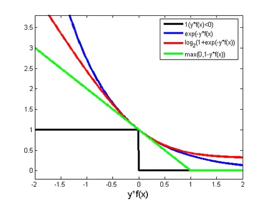

  • How should I understand the typical hinge loss graph? Are they just gross oversimplifications? For example, the green line represents the hinge loss function you see in every image in a Google search for "hinge loss".

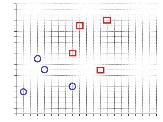

**Please, **Can someone provide (for the world) a simple example of hinge loss minimization? Let's say I have four negative points (blue circles) and four positive points (red squares). What would the loss function look like? How do I minimize (mathematically, and with intuition).

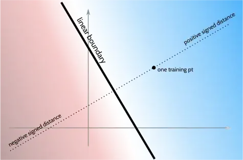

  2. If it helps to think geometrically, a plane can be completely defined by two parameters: a vector $\vec{w}$ perpendicular to the plane (which tells you the plane's orientation) and an offset $b$ (which tells you how far it is from the origin). Each choice of $\langle \vec{w}, b\rangle$ is therefore a choice of plane. Another helpful geometric fact for intuition: if $\langle \vec{w}, b\rangle$ is some plane and $\vec{x}$ is a point in space, then $\vec{w}\cdot \vec{x} + b$ is the distance between the plane and the point (!).
    [Nitpick: If $\vec{w}$ is not a unit vector, then this formula actually gives a multiple of a distance, but the constants don't matter here.]
  3. That planar-distance formula $\hat{y}(\vec{x}) \equiv \vec{w}\cdot \vec{x} + b$ is useful because it defines a measurement scheme throughout all space: points lying on the plane have a value of 0; points far away on one side of the boundary have increasingly positive value, and points far away on the other side of the boundary have increasingly negative value.

    Your graphs show how different loss functions behave on a single point whose class $y=+1$ is fixed and whose planar distance $\hat{y}$ varies ($\hat{y}$ runs along the horizontal axis). This can give you an idea of what the loss function is prioritizing. (Under this scheme, by the way, positive values of $\hat{y}$ correspond to increasingly confident correct classification, and negative values of $\hat{y}$ correspond to increasingly confident incorrect classification.)

    For a dataset as in the 2D picture provided, first draw any linear boundary; call one side the positive (or red square) side, and the other the negative (or blue circle) side. You can compute the loss of the boundary by first measuring the planar distance values of each point; here, the signed distance between each training point and the boundary. Points on the positive side have positive $\hat{y}$ values and points on the negative side have negative values. Next, each point contributes to the total loss: $L = \sum_i \ell(\hat{y}, y)$. Compute the loss for each of the points now that you've computed $\hat{y}$ for each point and you know $y=\pm 1$ whether the point is a red square or blue circle. Add them all up to compute the overall loss.
    The best boundary is the one that has the lowest loss on this dataset out of all possible linear boundaries you could draw. (Time permitting, I'll add illustrations for all of this.)

Addendum: As you can see from the shape of the curves, the loss functions in your picture express the following scoring rubrics:
  • Zero-one loss $[y\hat{y} < 0]$ : Being misclassified is uniformly bad— points on the wrong side of the boundary get the same size penalty regardless of how far on the wrong side they are. Similarly, all points on the correct side of the boundary get no penalty and no special bonus, even if they're very far on the correct side.
  • Exponential loss $[\exp{(y\hat{y})}]$ : The more correct you are, the better. But once you're on the correct side of the boundary, it gets less and less important that you be far away from the boundary. On the other hand, the further you are on the wrong side of the boundary, the more exponentially urgent of a problem it is.
  • $\log_2(\cdots)$ : Same, qualitatively, as previous function.
  • Hinge loss $\max(0, 1-y\hat{y})$ : If you're correctly classified beyond the margin ($\hat{y}>1$) then it's irrelevant just how far on the correct side you are. On the other hand, if you're within the margin or on the incorrect side, you get a penalty directly proportional to how far you are on the wrong side.

Now, let's work on your particular example, let's get the coordiante first.
The data for the negative class are:
$$(x=(1,4), y=-1), (x=(3,10), y=-1), (x=(4,8), y=-1), (x=(8,5), y=-1)$$
The data for the positive class are:
$$(x=(8,11), y=1), (x=(9,16), y=1), (x=(12,8), y=1), (x=(13,17), y=1)$$
With that the data set. The function that we want to minimize is
\begin{align}f(b,w_1,w_2) &= \frac18 \left[\max(0, 1+(b+w_1+4w_2)) + \max(0, 1+(b+3w_1+10w_2))\right.\\&+ \max(0, 1+(b+4w_1+8w_2)) + \max(0, 1+(b+8w_1+5w_2))\\&+ \max(0, 1-(b+w_1+4w_2)) + \max(0, 1-(b+3w_1+10w_2))\\&+ \left.\max(0, 1-(b+4w_1+8w_2)) + \max(0, 1-(b+8w_1+5w_2))\right]\\&+ w_1^2+w_2^2 \end{align}
This formulation can be rewritten as
$$\min \frac18 \sum_{i=1}^8 t_i +w_1^2+w_2^2$$
subject to $$t_i \ge 1-y_i(b+w_1x_{i1}+w_2x_{i2}) \forall i \in \{ 1, \ldots, 8\}$$ $$t_i \ge 0 \forall i \in \{ 1, \ldots, 8\}$$
Now, we have even more variables. Fortuantely, it is a special type of problem known as quadratic programming of which its solver is widely available. And for the special problem of minimizing regularized the hinge loss, there is a special name to it known as support vector machine and most modern programming language has library to solve it.
