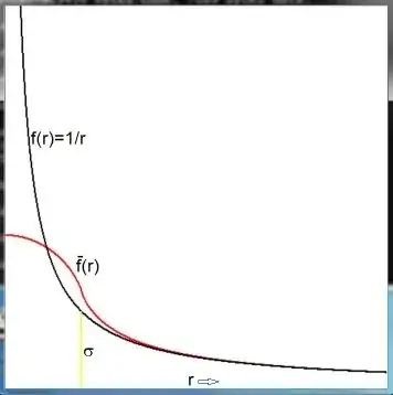

The goal of Renormalization is that it must be capable of removing singularities. Can our technique do that? The simplest example I can think of is two-dimensional - which is typical: I couldn't find a decent one-dimensional example. Whatever might be the reason: $$ f(r) = \frac{1}{r} \qquad ; \qquad D_\sigma(r) = \left\{ \begin{array}{lll} 1/(\pi \sigma^2) & \mbox{for} & r \le \sigma \\ 0 & \mbox{for} & r > \sigma \end{array} \right.$$ Because by introducing polar coordinates we have $\,x = r\cos(\theta)\,$ and $\,y = r\sin(\theta)$ ; $\,\xi = \rho\cos(\phi)\,$ and $\,\eta = \rho\sin(\phi)\,$ and $\,d\xi\,d\eta = \rho\,d\rho\,d\phi$ . Renormalization then goes as follows: $$ f(r) = \frac{1}{r} \quad \Longrightarrow \quad \overline{f}(r) = \iint D_\sigma(\sqrt{\xi^2+\eta^2}) \frac{d\xi d\eta}{\sqrt{(x-\xi)^2+(y-\eta)^2}} = \\ \frac{1}{\pi \sigma^2} \int_0^{2\pi} d\phi \int_0^\sigma \frac{\rho\,d\rho}{\sqrt{r^2+\rho^2-2r\rho\cos(\phi-\theta)}} $$ But we only have to calculate $\,\overline{f}\,$ at the singularity $\,r=0$ , which simplifies the problem a whole lot: $$ \overline{f}(0) = \frac{1}{\pi \sigma^2} \int_0^{2\pi} d \phi \int_0^\sigma d\rho = \frac{2}{\sigma} $$ It is seen that the singularity is indeed removed, that is: it is replaced by a number $2/\sigma$ which goes to infinity - as it should - if we only let $\sigma\to 0$ . But suppose that nobody wants the latter .. :-)
Update. Below is a (computer) sketch of functions involved with the example
for $\sigma=1$ and xmin := 0; xmax := 5; ymin := 0; ymax := 5; :
