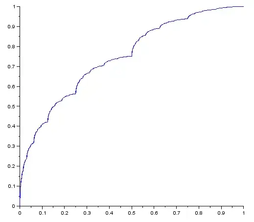

Here is a piece of this function with $r=1/4$:
derivative = 0 a.e.

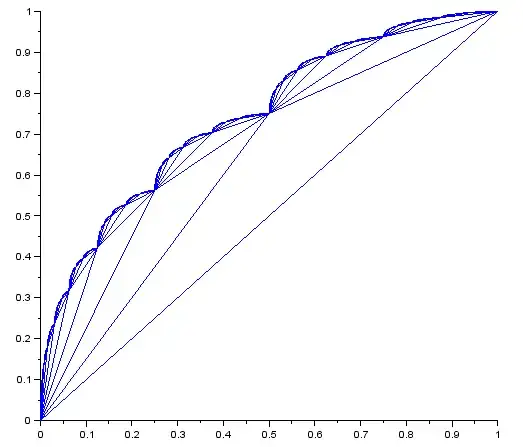

and for clarity, here is the family $f_0$,$f_1$,... shown together. All the construction does is replace each line segment of previous step with two; sort of like von Koch snowflake, but less pointy. (It's a monotonic version of the blancmange curve).
