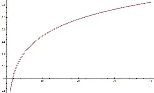

Is the following inequality true? $$\gamma -\frac{\zeta ''(-2\;n)}{2 \zeta '(-2\;n)} > \log (n)-\gamma$$
This for $n$ a positive integer, $n=1,2,3,4,5,...$, and more precisely when $n$ approaches infinity.
$\gamma$ is the Euler-Mascheroni constant, $\zeta(s)$ is the Riemann zeta function and $\zeta'(s)$ is a derivative.
Plotting the left hand side (red) and the right hand side (blue):
right hand side left hand side
we see that they are close to each other. Mathematica program for the plot:

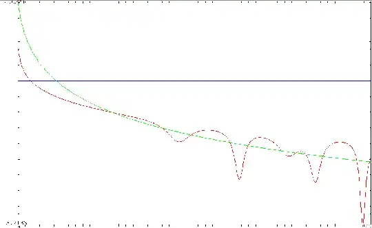

Let's illustrate this by showing the left (irregular) $\,\Re\frac{\zeta''(\rho)} {\zeta'(\rho)}$ part and right (regular) $-2\theta(t)$ part of $(8)$ for $1<t<50$ :
left and right part of 8

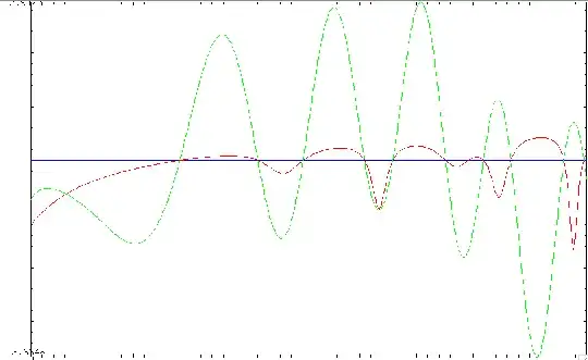

If we subtract these two curves we will obtain a new curve taking the value $0$ only when the formula $(8)$ applies. The second curve is the real Riemann Z-function (i.e. $\zeta$ 'without the phase') taking the value $0$ only at the imaginary parts of the zeros :
zeros of zeta
In the $(1,50)$ range considered $(8)$ has only one additional solution for $t$ a little smaller than $40$.
