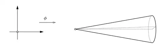

As an easy example, you can consider two different metrics on $\Bbb{R}^2\setminus\{\bf{0}\}$. The first metric is the Euclidean metric, and it is obviously non-complete.
The second metric is the pull-back metric of the cylindrical metric, that is considering the homeomorphism: $$f:\Bbb{R}^2\setminus\{\mathbf{0}\}\longrightarrow \Bbb{R}\times S^1$$ we use polar coordinates $(r,\theta)$ on $\Bbb{R}^2\setminus\{\mathbf{0}\}$, and $$f(r,\theta)=(\log r,\theta)\in\Bbb{R}\times S^1$$ therefore, the cylindrical pull-back metric tensor on $\Bbb{R}^2\setminus\{\mathbf{0}\}$ write as $$g=\frac{dr^2}{r^2}+(\log r)^2d\theta^2$$ this is obviously a complete metric.
the cylindrical metricthe Euclidean Metric
Z. Liu
