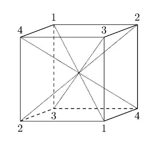

Surjective: The group of rigid motions of a cube contains $24$ elements, same as $S_4$. Proof - A cube has $6$ sides. If a particular side is facing upward, then there are four possible rotations of the cube that will preserve the upward-facing side. Hence, the order of the group is $6\times 4 = 24$.
Injective: A cube has $4$ diagonals. For one of the diagonals's head and tale attach $1$, for another $2$ and so on. We choose tale and head of a diagonal same, since there is no way to have rigid motion for a cube to change head and tale and still the diagonal remains in same orientation. For first diagonal you can attach any one of $1$, $2$, $3$, or $4$, as you could choose for first place in $S_4$. For the second diagonal it remains $3$ numbers to choose to attach as same for the second place in $S_4$. And till the last one, and we are done.
pic
