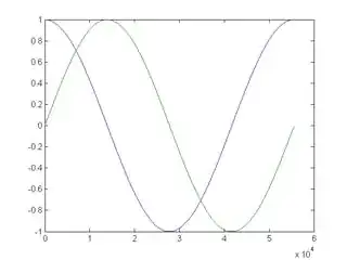

Further when you take $n$ to the limit of infinitely large roots of $M(n)$, the single addends approach the cosine function,
$\hskip1.8in$enter image description here
which again makes it easy to determine the value of the sum resp. integral, but
