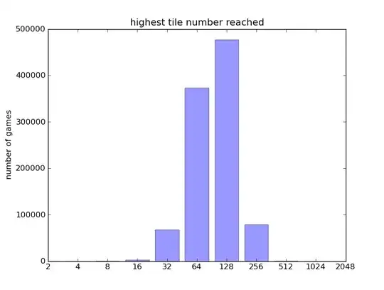

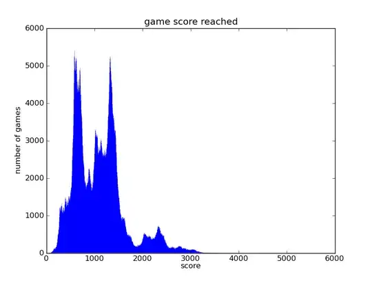

I implemented a simulation of 2048, because I wanted to analyze different strategies.
Unsurprisingly, the result is that moving at random is a really bad strategy. enter image description here Above you can see the scores of $1000000$ random games (edit: updated after bugfix, thanks to misof). The score is defined as the sum of all numbers generated by merge. It can be viewed as a measure of how far you make it in the game. For a win you need a score of at least $16384$. You can see that most games end in a region below $2000$, that is they generate at most a 128-tile and loose subsequently. The heap on the right at $2500$ represents those games that manage to generate a 256 tile - those games are rather rare. No game made it to the 1024-tile.
Upon request, here is the plot for highest number on a tile: enter image description here When it comes to "dumb strategies", you get better results cycling moves deterministically: move up, right, up, left and repeat. This improves the expected highest number by one tile.

    What do the axes denote? – ShreevatsaR Mar 26 '14 at 11:53
    It's a histogram showing how many games (y-axis) end with a specific score (x-axis) which is defined in the game as the sum of all merged numbers. Plotted in bins of 30. – benh Mar 26 '14 at 14:30
    This answer would be super-awsome if the x-axis were highest tile number achieved, but probably the relevant data does not exists at this point? (I know that one can re-run, since you given the code, but if someone already did at least half of the work, maybe there is a chance.) – luk32 Mar 26 '14 at 16:10
  • @luk32 I added axes descriptions and a plot for highest tile number. – benh Mar 26 '14 at 22:03

The stats in the answer by @benh are incorrect. There is at least one bug I know of in his code, and it causes the stats he posted to be lower than they should. The bug I see is in how he detects the end of the game. In his simulations he ended the game as soon as the board becomes full. However, in 2048 the game is only over once that happens and no two adjacent tiles share the same number.
Below are the results of my simulations with a proper terminating condition.
