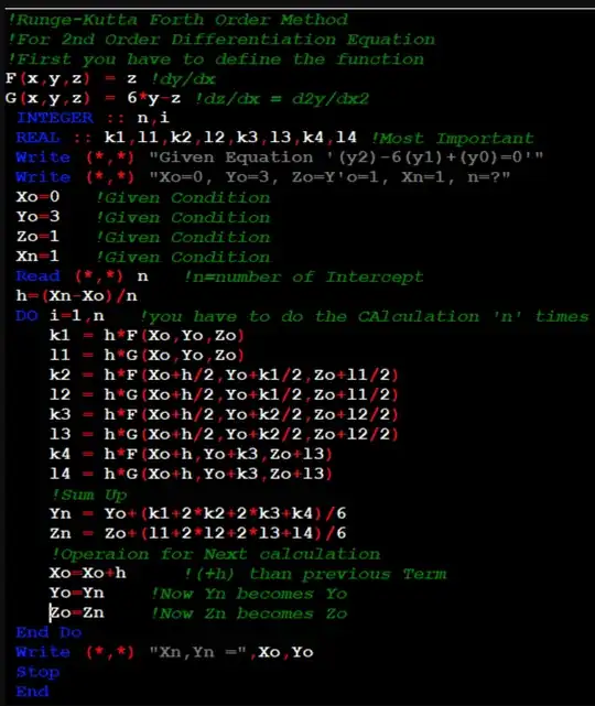

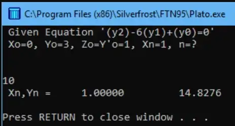

A Fortran code shown below:
produces the following result
output
!Runge-Kutta Fourth Order Method
!For 2nd Order Differentiation Equation
!First you have to define the function
F(x,y,z) = z !dy/dx
G(x,y,z) = 6*y-z !dz/dx = d2y/dx2
INTEGER :: n,i
REAL :: k1,l1,k2,l2,k3,l3,k4,l4    !Most Important
Write (*,*) "Given Equation '(y2)-6(y1)+(y0)=0'"
Write (*,*) "Xo=0, Yo=3, Zo=Y'o=1, Xn=1, n=?"
Xo=0    !Given Condition
Yo=3    !Given Condition
Zo=1    !Given Condition
Xn=1    !Given Condition
read (*,*) n    !n=number of Intercept
h=(Xn-Xo)/n
do i=1,n    !you have to do the Calculation 'n' times
k1 = h*F(Xo,Yo,Zo)
l1 = h*G(Xo,Yo,Zo)
k2 = h*F(Xo+h/2,Yo+k1/2,Zo+l1/2)
l2 = h*G(Xo+h/2,Yo+k1/2,Zo+l1/2)
k3 = h*F(Xo+h/2,Yo+k2/2,Zo+l2/2)
l3 = h*G(Xo+h/2,Yo+k2/2,Zo+l2/2)
k4 = h*F(Xo+h,Yo+k3,Zo+l3)
l4 = h*G(Xo+h,Yo+k3,Zo+l3)
!Sum Up
Yn = Yo+(k1+2*k2+2*k3+k4)/6
Zn = Zo+(l1+2*l2+2*l3+l4)/6
!Operation for Next calculation
Xo=Xo+h     !(+h) than previous Term
Yo=Yn    !Now Yn becomes Yo
Zo=Zn    !Now Zn becomes Zo
End Do
Write (*,*) "Xn,Yn =",Xo,Yo
Stop
End
