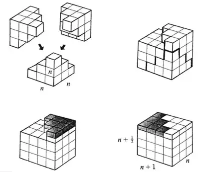

    If you're not working on this being particularly rigorous, you could interpret the sum as a square pyramid, and then quote the volume for such a shape. – preferred_anon Mar 19 '14 at 13:27

  • @DanielLittlewood I like your suggestions. If you formulate them as an answer, you'll have my upvote. – Federico Poloni Mar 19 '14 at 13:41
  • @FedericoPoloni Done, glad to be of help. – preferred_anon Mar 19 '14 at 13:56

    Nice. This also answers why formula of volumes of pyramids also include 1/3 in them instead of going through the integral. Easier to explain for secondary school! – user88595 Mar 19 '14 at 13:41

There are a couple of ways to make this limit seem intuitive. The sum of the squares can be interpreted as a square pyramid; the volume of such a pyramid is approximately $\frac{1}3 n^{3}$.
