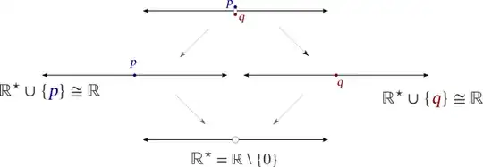

47

Now we add another new point $q$, in exactly the same way we added $p$: if $U$ was open before, and $0\in U$, then $U\setminus\{0\}\cup\{q\}$ is open now. This set is exactly $U$, but with $0$ replaced by $q$.
R^\star with points p and q both replacing 0
So now we have something like $\Bbb R$, except it has this extra point $q$. But $q$ has all the same properties that $p$ has! And in particular, just as $p$ was a perfect replacement for the origin $0$ that we deleted, $q$ is also a perfect replacement for the origin $0$ that we deleted.
And just as $\rstar\cup\{p\}$ was homeomorphic to $\Bbb R$, so is $\rstar\cup\{q\}$ homeomorphic to $\Bbb R$.
But this new space is $\rstar\cup\{p,q\}$ and has both $p$ and $q$. We can delete either one of them and get a space identical to $\Bbb R$.
We deleted the origin $0$ and replaced it with $p$ and with $q$, so we now have something like $\Bbb R$, except that instead of one origin it has two, $p$ and $q$.
Four versions of R with the point 0 removed.  In the top one, it has been replaced by both p and q; in the left middle with p only; in the right middle with q only, and at the bottom with neither.
So it is called the line with two origins.
