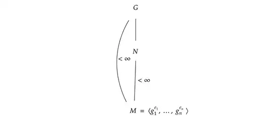

Assume that $G$ is generated by $g_1.\dots,g_n$ and consider a subgroup $N\le G$. If $N \cap \langle g_i \rangle = \{1\}$ for some $i= 1,\dots, n$ (assume w.l.o.g that $i =1$), then the following quotient homomorphism \begin{equation} \pi\colon G \longrightarrow G/\langle g_1 \rangle = \langle \pi(g_2),\dots,\pi(g_n) \rangle, \end{equation} is injective on $N$. So $N$ can be viewed as subgroup of $ G/\langle g_1 \rangle $ and by induction on the number of generators $n$, $N$ is finitely generated.
Now if for all $i$, we have that $N \cap \langle g_i \rangle \ne \{1\}$ , then $N \cap \langle g_i \rangle = \langle g_i^{e_i} \rangle $. This implies that $M :=\langle g_1^{e_1},\dots, g_n^{e_n} \rangle \le N$. Since $M$ has finite index in $G$ (notice how the quotient $G/M$ has at most $e_1 \cdots e_n$ elements), we have the following picture,
<span class=$M$ has finite index in $N$" />
which shows that $M$ has finite index in $N$. Then $N$ is a finite union of cosets of $M$, and thus $N$ is finitely generated.
