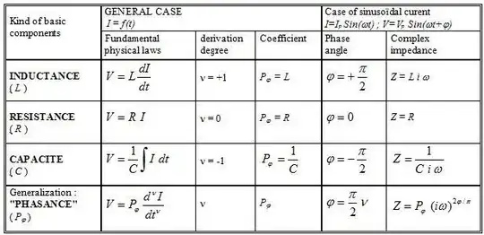

The bibliography about fractional calculus is extensive. After some precursors during the 18th century, the most striking advances are the ones of J.Liouville in several of it’s reports to the Ecole polytechnique in Paris between 1832 and 1835, then the contribution of B.Riemann in 1847, making that the names of these two mathematicians remain attached to the famous transform which is at the heart of differ-integral calculus.
More recently, the fractional calculus not only has important applications in pure mathematics (let us quote Erdélyi and Higgings, among number of authors), but also interests vast domains of the physical sciences. Heaviside was a brilliant precursor who, from 1920, used fractional calculus in the researches on the electromagnetic propagation [Oliver Heaviside, Electromagnetic Theory, 1920, re-édit.: Dover Pub., New York, 1950.]. Numerous examples are quoted in the book "The Fractional Calculus", Keith B.Oldham, Jerome Spanier, Academic Press,New York, 1974. For example concerning rheology, diffusion, hydrodynamics, thermodynamics, electrochemistry, etc.
In the paper "The fractionnal derivation" published on Scribd (tranlation pp.7-12) : http://www.scribd.com/JJacquelin/documents a formal generalization of some basic relationships for electrical components, thanks to the fractional derivation, appears on the table below (copy from the referenced paper, p.11). It had remarkable consequences on networks made of associations of these components, and on calculations of equivalent networks. This is more developed in the paper "The Phasance Concept" (same link on Sribd).
