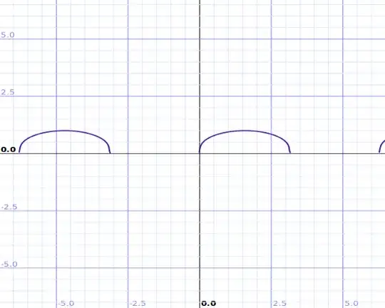

is continuous on that interval. Here is a graph of the function:
I can see that the function is continuous on the interval $[0, \pi]$ and not defined on the interval $(-\pi, 0)$. I have understood that continuity means that we can draw the graph "without lifting the pencil" at any point. But if I would draw the function $\sqrt[\leftroot{0}\uproot{0}3]{\sin(\theta)}$ on interval $[-\pi, \pi]$ then I would not have any gap on the interval $[0, \pi]$, but I would have a gap between the point $-\pi$ and the interval $[0, \pi]$. So is this then continuous or not on the interval $[-\pi, \pi]$?

    Your graph is not correct, since $\sin$ is defined on $\mathbb R$ and $\sqrt[3]{x}$ is defined on $\mathbb R$, so the composition $f(\theta)=\sqrt[3]{\sin(\theta)}$ is defined on $\mathbb R$. For example, $f(-\frac{\pi}{2})=\sqrt[3]{-1}=-1$.
    In addition, the claim that a continuous function is "drawn without lifting the pencil" (which is by the way, not a mathematical statement) is true only if f is continuous and defined on an interval.
    – Taladris Mar 06 '14 at 07:53
  • +1 @Taladris ah, you are correct =) I see now, I used online function grapher for this x) Guess the image got me confused =) – jjepsuomi Mar 06 '14 at 07:55

The cube root function is continuous in ${\Bbb R}$, $\sin$ is continuous in ${\Bbb R}$. Your function is continuous because is composition of two continuous functions.
  • +1 Thank you for your help, I noticed my graph from online grapher is not correct as stated in the comments =) – jjepsuomi Mar 06 '14 at 07:56
  • By the way I'm curious, I have tried four different online graphers and they all give the same graph. I have used as my input the function $\sin(x)^{1/3}$, shouldn't this be the cubic root of $\sin(x)$? – jjepsuomi Mar 06 '14 at 08:07
    Fractional powers of negative numbers are problematic for numerical computing. The computer can't tell the difference between $\alpha = 1/3$ and $\beta = \frac {33333333333333333}{100000000000000000}$. But a negative number to the power $\beta$ should be imaginary since $\beta$ has an even denominator. – Robert Israel Mar 06 '14 at 08:13
    On the other hand, for symbolic computation, many computer algebra systems prefer the "principal branch" of non-integer powers, defined by $z^\alpha = \exp(\alpha \text{Log}(z))$. Thus in Maple, $(-1)^{1/3}$ is not $-1$ but $e^{i\pi/3}$. – Robert Israel Mar 06 '14 at 08:16
  • +1 Thank you again =) @RobertIsrael will keep that in mind =) – jjepsuomi Mar 06 '14 at 08:24
  • @RobertIsrael The symbolic program Maxima draws correctly the function: plot2d((sin(x))^(1/3),[x,-10,10]). Surely you can change the default branch in Maple/Mathematica... – Martín-Blas Pérez Pinilla Mar 06 '14 at 08:26
  • In Maple, surd(x,n) can be used instead of $x^{1/n}$. – Robert Israel Mar 07 '14 at 03:10
