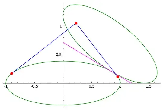

I'll concentrate on the symmetric case, as depicted here:
Illustration of the symmetric case

How to obtain them
Here is what I did: I defined all my geometry in terms of two parameters, $\alpha\approx 0.14778$ and $\beta\approx 0.77656$. The first defines the conic, as $\alpha x^2+y^2=1$. So contrary to my illustration and the figures above, I'm using $1$ as the length of the minor semiaxis and $\sqrt{\frac1\alpha}$ for the major internally, and the figures were scaled afterwards. I then interpret everything projectively, and use the second parameter to define $(1,\beta,0)^T$ and $(-\beta,1,0)^T$, two points at infinity which represent bundles of parallel lines, the two bundles orthogonal to one another. From these points I construct tangents to the central ellipse, and their point of intersection. These are the blue lines and red dots in the figure above. I then compute the transformation which maps these tangent lines to the coordinate lines, and apply it to the central ellipse to obtain the surrounding one which will certainly touch the coordinate axes.
Next I theoretically consider the two points of intersection which this ellipse might have with the central one. But more importantly, I consider the line joining these two points. The benefit here is on the one hand that this line is in fact easier to compute than the points of intersection, and that on the other hand the line will be real even if the ellipses no longer intersect in any real points.
Now the task can be formulated in terms of the position of this line wrt. the central ellipse: it must touch the central ellipse, and any change of $\beta$ in either direction must cause it to intersect the central ellipse, so it must be optimal in a certain sense. The adjoint of the matrix of the central ellipse will represent a quadratic form, and plugging the line into that form will result in a single number. According to the above conditions, this number must be both zero and optimal. In my choice of signs it must be maximal, but sign changes will occur easily.
Now comes the numeric refinement via bisection. Each loop adjusts first $\beta$ then $\alpha$. $\beta$ is adjusted towards optimality, while $\alpha$ is adjusted towards a root, where the result is zero. So in other words, I choose the angle such that the line is as close to the center of the central ellipse, then choose the eccentricity so that for that angle it still only touches the central ellipse. The adjustment is a pretty stupid bisection, which works since I always stay close to the actual solution and won't have to worry about other optima. Speed of convergence might be improved, but I'd rather keep the simplicity of my approach and wait a bit longer.
I've uploaded the sage code for my computations here. If anyone were to find symbolic expression for the minimal eccentricity, then I guess one could adjust my code to verify that.
