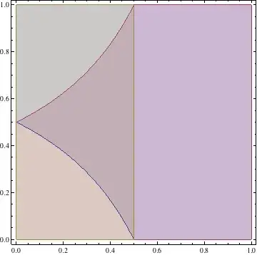

The three triangle inequalities are
\begin{align} x + y &> 1-x-y \\ x + (1-x-y) &> y \\ y + (1-x-y) &> x \\ \end{align}
Your problem is that in picking the smaller number first from a uniform distribution, it's going to end up being bigger than it would if you had just picked two random numbers and taken the smaller one. (You'll end up with an average value of $1/2$ for the smaller instead of $1/3$ like you actually want.) Now when you pick $y$ on $[0, 1-x]$, you're making it smaller than it should be (ending up with average value of $1/4$). To understand this unequal distribution, we can substitute $y (1-x)$ for $y$ in the original inequalities and we'll see the proper distribution.
(Note that the $y$-axis of the graph doesn't really go from $0$ to $1$; instead the top represents the line $y=1-x$. I'm showing it as a square because that's how the probabilities you were calculating were being generated.) Now the probability you're measuring is the area of the strangely-shaped region on the left, which is $$\int_0^{1/2}\frac1{2-2x}-\frac{2x-1}{2x-2}\,dx=\ln 2-\frac12\approx0.19314$$ I believe that's the answer you calculated.

    Nice. Your visualization (and the substitution of y(1-x) for y) is much nicer than the way that I'd solved the problem. – Isaac Jul 25 '10 at 06:40
    Thanks! I was about to go to sleep but then I stumbled upon your question and the opportunity to solve it and figure out the mystery was just too great to pass up. :P – Sophie Alpert Jul 25 '10 at 06:42
  • It's a favorite problem of mine because it starts with a classic geometric probability problem and ends up in calculus and with a ln(2). – Isaac Jul 25 '10 at 06:43
    It's probably obvious to most, but the correct way to simulate the problem is to generate two unequal random numbers in (0,1) and treat them as your cutting points. – BlueRaja - Danny Pflughoeft Jul 25 '10 at 07:19
  • Maybe I'm to novice for understanding, but why we substite $y$ by $y(1-x)$? What's the logic? Thanks for your help. – hlapointe Oct 17 '15 at 21:34
    @hlapointe If the first break gives a stick with length $x$, then the remaining length is $1-x$. Splitting that randomly is the same as multiplying by a random number $y$ between $0$ and $1$, so we get $y(1-x)$. – Sophie Alpert Oct 18 '15 at 20:31
