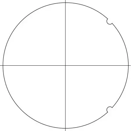

where $C$ is the following contour:
$C$ is the positively-oriented unit circle deformed at $z=e^{\pm i \phi}$ by semicircles of radii $\epsilon$ into the unit circle. Thus, the only pole of the integrand is at $z=0$.
