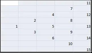

I am trying to program a binomial tree in Matlab. The tree looks something like this:
The numbers in the picture refer to the index of the array to create a binomial tree.
Problem:
Value of 2 = 0.5*Value of 4 + 0.5*Value of 5
Value of 3 = 0.5*Value of 5 + 0.5*Value of 6
I need to link the value of 2 to value of 4 and value of 5, similarly for value of 3 accordingly.
How do i get the link mathematically so that I can program it, instead of stating it manually?
I hope the problem is clear. Need some guidance on this.

lakshmen
  • 1,035
    You need to separate $5$ from $3$ since what you have now isn't a binomial tree. Child nodes are not shared between parent nodes. – John Habert Feb 08 '14 at 20:20
  • @JohnHabert good spot, I was writing an answer based on a binary tree and was about to post it and noticed my formula didn't work... – TooTone Feb 08 '14 at 20:22
  • @JohnHabert True isn't a binary tree or any kind of tree, but it does sound like a reasonable DAG that might reasonably be described as "binomial" (in reference to Pascal's triangle). I ask the OP to clarify this. – Erick Wong Feb 08 '14 at 20:22
  • However this is a binomial (not binary) tree as used in finance for calculating prices of assets that depend upon other assets. – TooTone Feb 08 '14 at 20:23
  • @TooTone yes i am trying to model the a binomial tree in finance... – lakshmen Feb 08 '14 at 20:23
  • @lakesh What you probably want is a simple way to convert back and forth between indices and column/position coordinates. E.g. 3 is located in the position 2 of column 2, and its children are positions 2 and 3 of column 3. This isn't hard at least in one direction...have you given thought to this approach? – Erick Wong Feb 08 '14 at 20:24
  • @ErickWong I just showed a example. It was in Excel to simplify things. But I am using arrays to program it. Need some link between them. I have given thought but it wasn't working.. – lakshmen Feb 08 '14 at 20:25
  • Guess I was wrong about binomial tree. I'm used to trees from math and CS not business. – John Habert Feb 08 '14 at 20:27
  • @lakesh Can you give a little more detail about how you are programming this? Single array for the whole tree? Are calculations done top (left in your picture) to bottom (right) or bottom to top? – John Habert Feb 08 '14 at 20:28
  • @JohnHabert Sure. Just a sec... – lakshmen Feb 08 '14 at 20:29
  • @lakesh You could use lookup tables. I.e. two more arrays of the same size to contain the indices of the upper and lower children. – TooTone Feb 08 '14 at 20:33
  • @TooTone I don't think i can use that because I still need to optimize the values in the cell.. – lakshmen Feb 08 '14 at 20:35
The bottom numbers on your columns are the triangular numbers $\frac 12n(n+1)$ where $n$ is the column number. If you have a number, say $5$, the number up and to the right is $5+n$, where $n$ is the column number of $5$ and the number down and to the right is $5+n+1$. We will be done if we can find the column number from the entry.
Given a triangular number $m$, its column number is the $n$ such that $m=\frac 12n(n+1)$ or $n^2+n-2m=0$ We can use the quadratic formula to solve this: $n=\frac 12(-1+\sqrt{1+8m})$ So given an entry $m$ in your triangle, its column number is $\lceil \frac 12(-1+\sqrt{1+8m}) \rceil$
For a test, let $m=13$. It column number is $\lceil \frac 12(-1+\sqrt {1+8\cdot 13})=\lceil \frac 12(\sqrt{105}-1 )\rceil=\lceil \frac 12(10.25-1) \rceil =5$ and the numbers next to it are $18,19$
Ross Millikan
  • 383,099
  • is it Sqrt(105) and 0.5(sqrt(105)-1) = 4.62. How did u get 5? – lakshmen Feb 08 '14 at 20:47
  • The ceiling brackets tell you to round up to the next integer. – Ross Millikan Feb 08 '14 at 20:50
  • ok thanks alot... – lakshmen Feb 08 '14 at 20:51
  • one more qn, how do u find the parent node of a recombining tree? do u any have idea? – lakshmen Feb 11 '14 at 17:20
  • Which is the parent node of 13? – Ross Millikan Feb 11 '14 at 17:25
  • both 8 and 9 are parents... need your guidance on finding the parent node... – lakshmen Feb 11 '14 at 17:28
  • You get the parent above by subtracting the column number and the parent below by adding 1 to that. You can detect that there is not a parent below by the fact that the round up isn't necessary-that the square root comes out even. Equivalently you can check that $m=\frac 12n(n+1)$ You can detect that there is no parent above if $m=\frac12(n-1)n+1$ because it is one more than a triangular number – Ross Millikan Feb 11 '14 at 17:37
  • can show an example, didn't really get u... – lakshmen Feb 11 '14 at 17:44
  • As above, let $m=13$. We calculate $n=5$ as the column number. The parents are $13-5=8, 13-5+1=9$ If we had $m=15$, we could then notice that $m=\frac 125\cdot 6$, so it is at the bottom of the column and has no lower parent. If $m=11,$ we find $m=\frac 12(5-1)\cdot 5+1$, so we are at the top of a column and there is no upper parent – Ross Millikan Feb 11 '14 at 17:50
  • Thanks a lot. Btw i posted a qn called parent node of recombining tree. Add yours an answer there, I will upvote for u. – lakshmen Feb 11 '14 at 18:07
