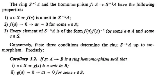

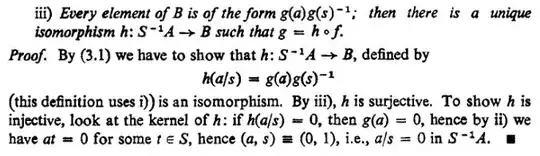

Since $R = A[x,y]/(xy-1)\,$ is a ring $\supset A[x]$ where $x$ is a unit, and every element has the form $f(x)/x^n,\, f\in A[x],\,$ it follows from the universal property of localization that $\,R \cong A[x]_x.\ $ Said universal property is the "general nonsense" being referred to, and it makes the result trivial.
Here is the relevant result Theorem from Atiyah & MacDonald, Commutative Algebra, p. 39.
Intuitively: the the conditions i), ii), iii) say that $B$ yields the most general (universal) way to invert all elements of $S$, namely ii) implies that it does not kill any more elements of $A$ than need be, and iii) implies that it has no more elements than need be ("no junk").

  • to check the conditions, is the following ok? (i) $x^n$ is unit since inverse is $y^n$. (ii) if $f=0$ in the quotient, $f=(xy-1)g$ for some $g$; but $f$ depends only on $x$ hence $f=0$. (iii) given any element of the quotient $\sum a_{nm} x^{n-m}$ say, this is equal to some polynomial in $x$ times $x^{-d}$, with $d$ the $y$ degree of the initial element. thanks! –  Jan 29 '14 at 20:47
