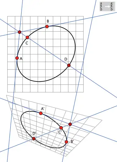

A more geometric approach does not compute the cross ratio, but instead construct a specific cross ratio, namely $-1$ so that you obtain a harmonic range. Here is a method to construct this: Construct tangents to the first conic in $A$ and $B$. Intersect these tangents, and connect the point of intersection with $C$. That line will intersect the conic in $C$ itself and one other point. Call this other point $D$. Do the same for the second conic to obtain $D'$. Then the uniquely determined homography from $A,B,C,D$ to $A',B',C',D'$ will map the first conic to the second.
Example illustration

  • If I understood you correctly, your "more geometric approach" assumes that, given $A$ and $B$, I am able to find the correspondent $A'$ and $B'$. How can I solve the problem of estimating the homography without knowing that correspondences but just having the matrix representation of the first and the second ellipse? – Alessandro Jacopson Apr 07 '16 at 10:26
  • @AlessandroJacopson: No, you misunderstood me: any points $A',B',C'$ on the second conic will work. At least if your objective is to find any homography between the two conics. If you need to find a specific homography, then you need to first specify additional constraints to choose that from among all the possible homographies which map one conic to the other. Of course, while “pick any point on the conic” is easy to say geometrically, if all you have is the matrix this still means e.g. finding a line that intersects the conic and computing the points of intersection. – MvG Apr 07 '16 at 11:13
