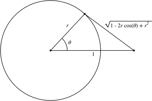

Considering the following diagram:
$\hspace{2cm}$enter image description here
we get that $$ \begin{align} \int_0^\pi\log\left(1-2r\cos(\theta)+r^2\right)\,\mathrm{d}\theta &=\int_0^{2\pi}\log\sqrt{1-2r\cos(\theta)+r^2}\,\mathrm{d}\theta\\ &=\mathrm{Re}\left(\int_\gamma\log(z-1)\frac{\mathrm{d}z}{iz}\right) \end{align} $$ along the path $\gamma=r\,e^{i[0,2\pi]}$.
If $r\le1$, the singularity at $z=0$ has residue $0$. Thus, the integral is $0$.
If $r\gt1$, then we need to modify the path to avoid the branch cut for $\log(z-1)$ along $\{t\in\mathbb{R}:t\ge1\}$. That is, in addition to the circular contour $\gamma=r\,e^{i[0,2\pi]}$, we need to follow the two contours $[r,1]$ below the real axis and $[1,r]$ above the real axis. The sum of the integrals along these two contours is $$ \int_r^12\pi i\frac{\mathrm{d}z}{iz}+\int_1^r0\frac{\mathrm{d}z}{iz}=-2\pi\log(r) $$ Since the integral along all three contours is $0$, the integral along the circular part must be $2\pi\log(r)$.
Putting these two cases together, we get $$ \int_0^\pi\log\left(1-2r\cos(\theta)+r^2\right)\,\mathrm{d}\theta =\left\{\begin{array}{l} 0&\text{if }r\le1\\ 2\pi\log(r)&\text{if }r\gt1 \end{array}\right. $$

  • I know this is old but can you explain why $\int_0^{2\pi}\log\sqrt{1-2r\cos(\theta)+r^2},\mathrm{d}\theta =\mathrm{Re}\int_\gamma\log(z-1)\frac{\mathrm{d}z}{iz}$? – Jay Lemmon Mar 29 '20 at 21:04
    Note that on the circle $|z|=1$, $\mathrm{d}\theta=\frac{\mathrm{d}z}{iz}$, and by the Law of Cosines, $|z-1|=\sqrt{1-2r\cos(\theta)+r^2}$. – robjohn Mar 29 '20 at 21:18
