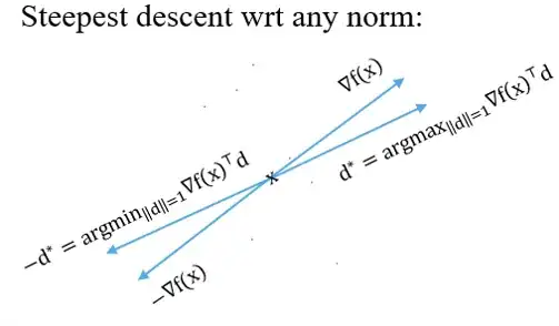

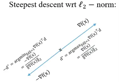

Consider a first order Taylor's approximation of a continuously differential function $f:U \to \mathbb{R}, U\subset \mathbb{R}^n$ at a point $x$ as follows:
$f(x+d)\approx f(x)+\nabla f(x)^\top d$, i.e. $f$ takes a small step in the direction $d$ at the point $x$. So, a normalized steepest descent can be defined as follows:
$\Delta x = argmin\{\nabla f(x)^\top d | \|d\|=1\}=-argmax\{\nabla f(x)^\top d | \|d\|=1\}=- d^*.$
Geometrical visualization of the steepest descent direction (with an example of $\ell _2 -$ norm) is as follows: enter image description here enter image description here
