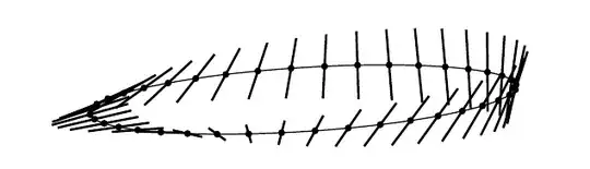

Let me explain two ways to derive the parametric equations:
  1. Coordinate transformations:
Think that you are in an amusement park and you are represented by a stick which rotates with respect to 2 axes at the same time. With respect to the big pole in the center of the rotating machine, and with respect to a center attached to the basket holding you. The horizontal rotation is moving at an angular speed $\omega$ and the vertical plane rotation (your basket) set to a different velocity $\omega/2$. If we take snapshots and gather them together we will observe something similar to what is drawn in Figure 1 below. enter image description here
We sampled the circumference every 10 degrees. If instead of sampling the circumference we run the sticks along a continuous path, we would have a recreation of the “half” twist Mobius strip. We say “half” because the rotation of the sticks is that of 180 degrees. We will generalize the concept of a rotating segment for a concept of a general f (x, 0, z) path in the vertical plane and from it compute the Mobius strip, but many Mobius-like solids can be computed with this method, with several cross-section shapes and any multiple twists of $\pi$.

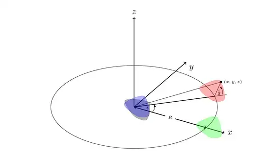

More generally: We consider a curve in the vertical plane $(x,0,z)$ given by an implicit equation $f(x,y,z)=0$, or better, by parametric equations
\begin{eqnarray} x = x(s) \quad , \quad y = y(s) \quad \text{and} \quad z = z(s). \end{eqnarray} and we want to apply the following transformations to this curve:
  • Rotatate the curve an angle $t/2$ in the vertical plane $(x,0,z)$.
  • Shift the origin along the $x$ axis by a distance $R > 0$.
  • Rotatate the curve an angle $t$ in the horizontal plane $(x,y,0)$.
The Figure below illustrates this: enter image description here
Initially we start with the parametric function $x'=x'(s), y'=y'(s):=0$, and $z'=z'(s)$ as a loop around the origin (gray color). We filled the interior of the loop for visualization purposes only but we are interested exclusively to whatever happens to the boundary which is the parametric function above. If the interior of the curve is taken into account, we will find "solid" Mobius bodies instead.
Here are the steps in the figure:
  • Rotate the gray curve by an angle $t/2$ with respect to the $y$ axis and obtain the purple curve.
  • Translate the purple curve (which will be always in a vertical plane) $(x,0,z)$ by a distance $R$, along the $x$ axis and obtain the green curve.
  • Rotate the green curve around the $z$ axis by an angle $t$ and obtain the pink curve.
Mathematically we write the three steps as follows:
  • Rotate by an angle $t/2$ about the $y$ axis \begin{eqnarray} \left ( \begin{array}{c} x \\ y \\ z \end{array} \right ) \mapsto \left ( \begin{array}{ccc} \cos t/2 & 0 & -\sin t/2 \\ 0 & 1 & 0 \\ \sin t/2 & 0 & \cos t/2 \end{array} \right ) \left ( \begin{array}{c} x' \\ y' \\ z' \end{array} \right ) \end{eqnarray}
  • Translate by $(R,0,0)$
    \begin{eqnarray} \left ( \begin{array}{c} x \\ y \\ z \end{array} \right ) \mapsto + \left ( \begin{array}{c} R \\ 0 \\ 0 \end{array} \right ) \end{eqnarray}
  • Rotate by an angle $t$ about the $z$ axis
    \begin{eqnarray} \left ( \begin{array}{c} x \\ y \\ z \end{array} \right ) \mapsto \left ( \begin{array}{ccc} \cos t & -\sin t & 0 \\ \sin t & \cos t & 0 \\ 0 & 0 & 1 \end{array} \right ) \left ( \begin{array}{c} x' \\ y' \\ z' \end{array} \right ) \end{eqnarray}
The three steps applied together produce \begin{eqnarray} \left ( \begin{array}{c} x \\ y \\ z \end{array} \right ) = \left ( \begin{array}{ccc} \cos t & -\sin t & 0 \\ \sin t & \cos t & 0 \\ 0 & 0 & 1 \end{array} \right ) \left [ \left ( \begin{array}{c} R \\ 0 \\ 0 \end{array} \right ) + \left ( \begin{array}{ccc} \cos t/2 & 0 & -\sin t/2 \\ 0 & 1 & 0 \\ \sin t/2 & 0 & \cos t/2 \end{array} \right ) \left ( \begin{array}{c} x' \\ y' \\ z' \end{array} \right ) \right ] \end{eqnarray}
The expansion of this expression produces the following equations: \begin{eqnarray} x &=& \cos t \left ( R - \sin \frac{t}{2} z' + \cos \frac{t}{2} x' \right ) - \sin t y' \\ y &=& \sin t \left ( R - \sin \frac{t}{2} z' + \cos \frac{t}{2} x' \right ) + \cos t y' \quad \quad (1) \\ z &=& \cos \frac{t}{2} z' + \sin \frac{t}{2} x' \end{eqnarray}
For the case of a M\"{o}bius strip we can start with a segment parametrized by \begin{eqnarray} x' = s \\ y' = 0 \\ z' = 0 \end{eqnarray} where $s \in [w/2,w/2]$ and $w/2 < R$. If $w/2 \ge R$ the surface will have self-intersections. In particular substituting this into equations (1) we find
\begin{eqnarray} x &=& \cos t \left ( R + \cos \frac{t}{2} s \right ) \\ y &=& \sin t \left ( R + \cos \frac{t}{2} s \right ) \quad \quad (1.2) \\ z &=& \sin \frac{t}{2} s \end{eqnarray} which is the parametric equation of the Mobius strip.

    2. Ruled Surfaces:
A different approach to this problem is by the use of https://en.wikipedia.org/wiki/Ruled_surface} Ruled Surfaces.
Look at the first figure above again (with the rotating sticks). This suggest that the Mobius strip can be generated as a collection of segments defined by the equation:
\begin{eqnarray} \Sigma(s,t) = p(t) + s u(t). \quad \quad (2) \end{eqnarray}

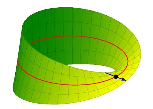

Here $u$ is a unit vector which points in the direction of the segment. In the case of a Mobius band we have that the vector $u(t)$ is given by the polar-spherical coordinates \begin{equation} u(t) = (\cos \frac{t}{2} \cos t, \cos \frac{t}{2} \sin t, \sin \frac{t}{2}) \end{equation} and $p(t)$ is the point sitting at the origin of the segment (in this case in the middle of it). The points $p(t)$ are sitting in a curve called directrix curve which in the case of the M\"{o}bius band is a circle with radius $R$. For the case of the Mobius strip we have that \begin{equation} p(t) = (R \cos t, R \sin t, 0). \end{equation} By substitution of the origin and direction vectors into the surface (2) we arrive to the same parametric equations(1.2) for the Mobius band. The straight segments with directions $u(t)$ are called generators of the surface. While some surfaces can have multiple generators, the Mobius band has only one generator so it is called a single ruled surface.
The result is shown in the next Figure: enter image description here
