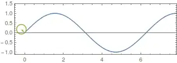

Having gotten that pet peeve out of my chest, here's a nice cartoon to help you (and more so me) relax:
Using the general approach given in this answer, and using the arclength expression demonstrated in this answer, the parametric equations for the "sinusoidal cycloid" can be expressed in matrix-vector format as
$$\begin{pmatrix}t\\\sin t\end{pmatrix}+\frac1{\sqrt{1+\cos^2 t}}\begin{pmatrix}1&-\cos t\\\cos t&1\end{pmatrix}\begin{pmatrix}-r \sin\left(\frac{\sqrt{2}}{r}E\left(t\mid\frac12\right)\right)\\r-r \cos\left(\frac{\sqrt{2}}{r}E\left(t\mid\frac12\right)\right)\end{pmatrix}$$
where $E(\phi\mid m)$ is the incomplete elliptic integral of the second kind, which is a nonelementary function.
