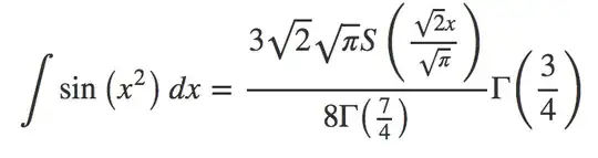

By Geogebra, the result is:
But if you do it in python with below code:
import sympy as sym
from IPython.display import display
a = Integral(sin(x**2), x)
b = Eq(a,a.doit())
display(b)
The result is:
But I don't know how to understand the difference.
