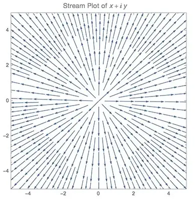

First we take a look at the regular Complex Plane. Noting that everything is simply uniformly increasing in value as we move away from the Origin.
Default Complex Plane

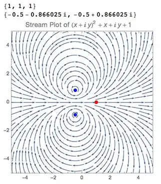

Taking a 2nd Degree Polynomial we see the result is very different.
The first List gives the coefficents, plotted as red dots.
The second List gives the roots, plotted as blue dots.
Notice how the Roots seem to act like the center of a swirling vortex "sucking" the rest of the Plane in.
The polynomial has "warped" the Complex Plane in such a way that the two points corresponding to the two roots have become singularities and poles.
If you are familiar with physics this is in fact very similar to models of magnetic dipoles. See for example: Why does the graph of $e^{1/z}$ look like a dipole?

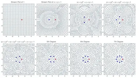

Here are more examples of Stream Plots of Polynomials from Degree 0 to 7.
More Examples
As you can see they start to form a circle around the origin. (Though note that the Roots of Polynomials with Coefficients other than one don't necessarily behave this way.)

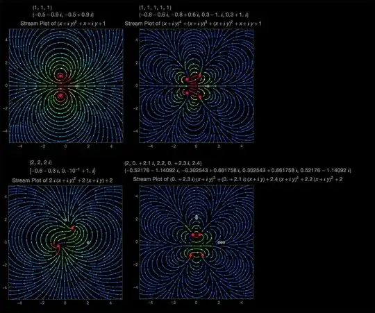

Since people seem to like the Stream Plots I tweaked the visuals a bit.
The Roots are now red dots and the Coefficents grey dots.
prettier stream plots
The last two are also examples of Polynomials with Coefficients other than 1.

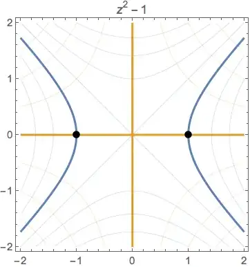

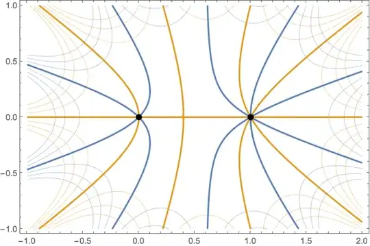

Here's another approach to visualizing the zeroes of a complex function $f(z)$. The idea is to plot contour diagrams of both the real and imaginary parts of $f(x+iy)$. The points of intersection of the zero contours are exactly the roots of $f$. Furthermore, the diagrams tend to look pretty cool as the real and imaginary contours meet at right angles.
As a simple example, consider $f(z)=z^2-1$, so that $$f(x+iy) = x^2-y^2-1 + 2xy\,i.$$ Now, the contours of the real part $u(x,y)=x^2-y^2-1$ are the blue hyperbolas below and the contours of the imaginary part are the gold hyperbolas. The zero contours are bold and we see that the real and imaginary zero contours intersect at the points $\pm1$, which are, of course, the roots of $f$.

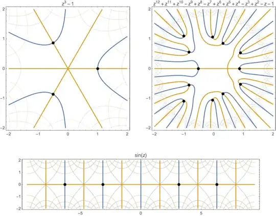

Here are a few more examples.
Note also that you can see the multiplicity of the root by counting the number of intersections. For example, $f(z)=z^2(z-1)^3$ has a root of multiplicity 2 and another of multiplicity 3.
